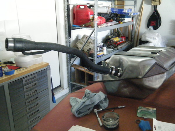

Been awhile since I had some time to work on the 'Vair, but finally got to spend a Saturday in the garage.

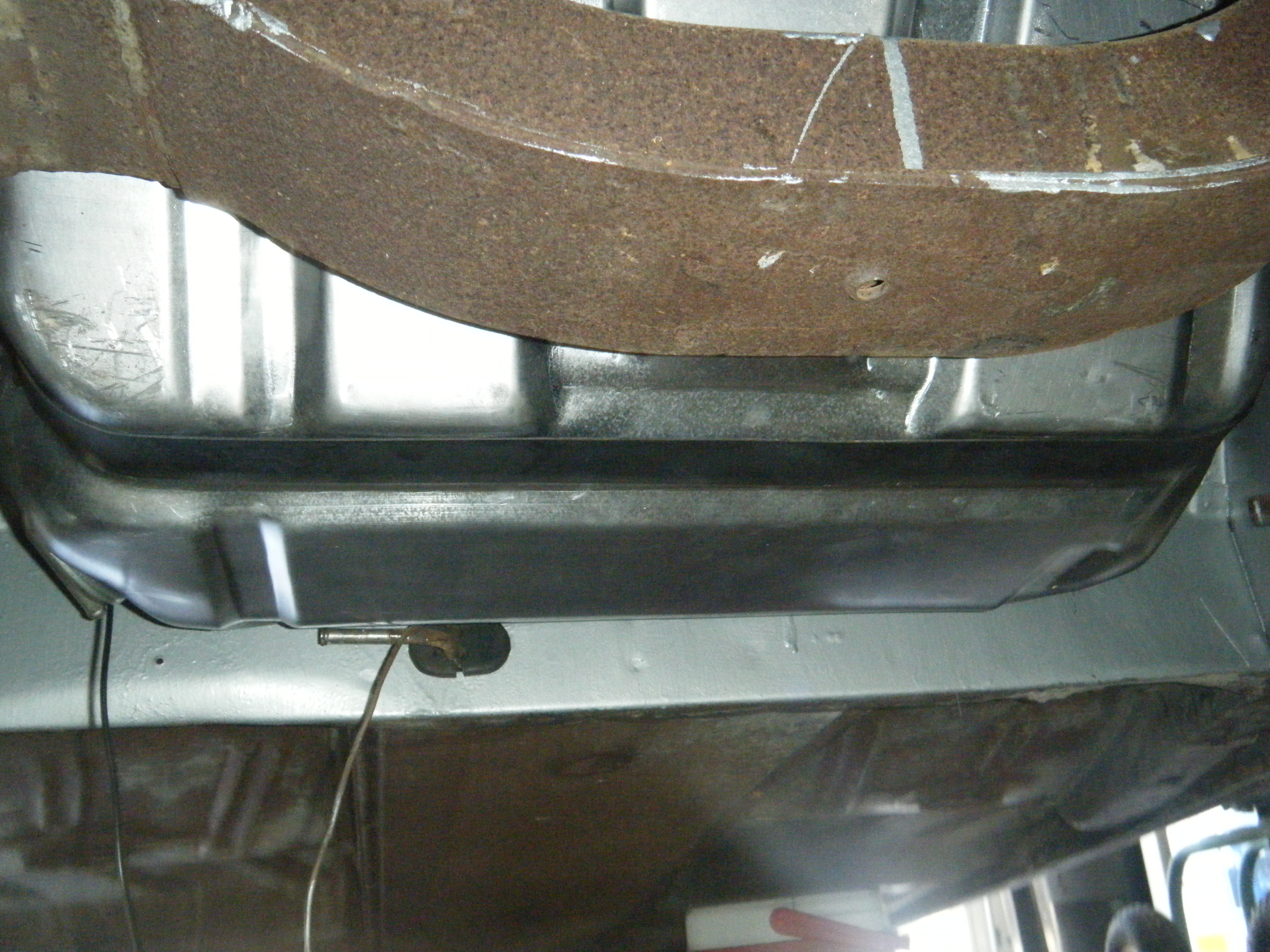

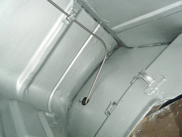

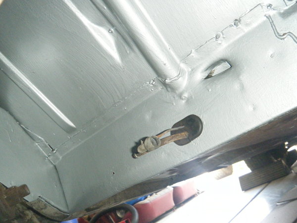

While waiting on the brake line kit to come in, I slapped some Rust Bullet up into the tank cavity. Kind of an experiment really. I did VERY little prep just to see what this stuff was all about. Scuffed up the big stuff, ran a quick 320 grit over it (VERY quickly), and wiped it down twice to get most of the sand and rust/dust off.
The Rust Bullet seems to work pretty good and sticks pretty well with my terrible prep job. It's pretty nasty to work with though. Fumes are PRETTY bad. Especially upside down, laying on the floor, painting with a brush over my face. The rest of the undercarriage can wait, that's for sure. Did 2 coats with a quick brush.
Brake lines are routed, but not hooked up on either end.
I'll be replacing all the grommets when I get to re-doing the brakes all the way around.

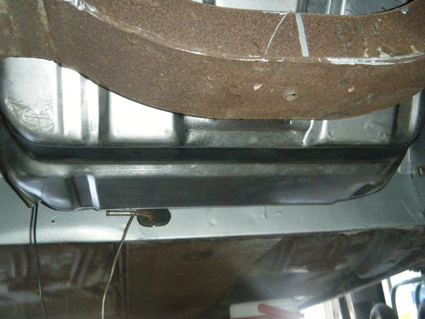

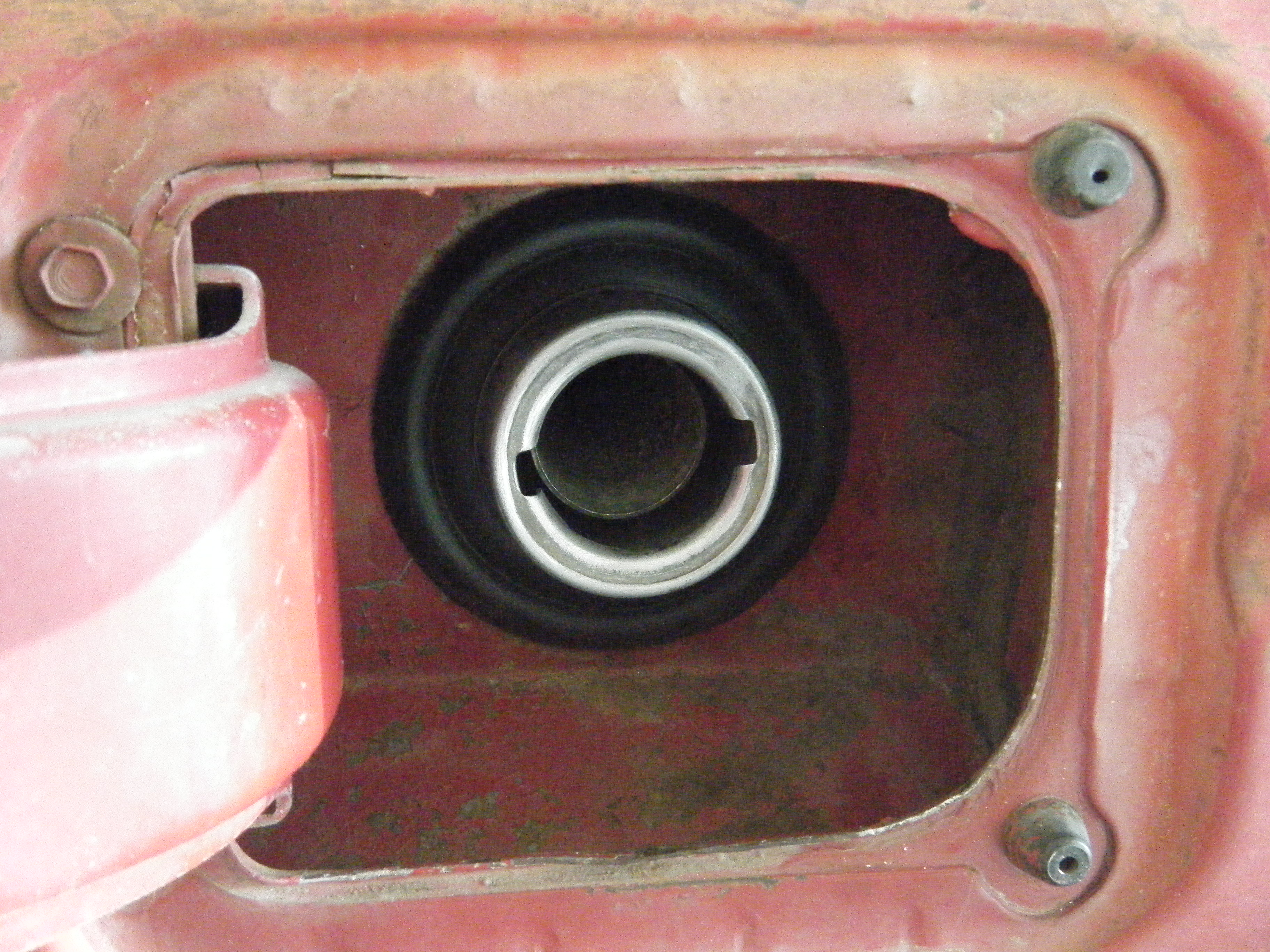

Tank filler cleaned up. Knocked it down with a wire brush and then sprayed it with some flat black Rustoleum. Hit the tank strap while I was at it. I understand that my prep work is sucking, but this is under car stuff and just wanted to clean it up a little.

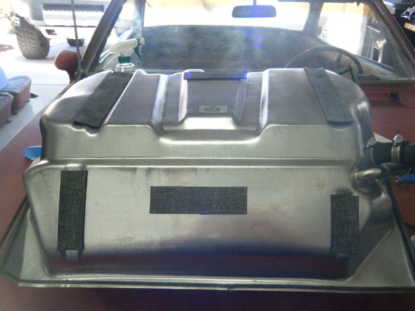

Couldn't find a definitive answer on the anti-squeak. Shop manual shows one vague pic, Clark's shows another, some people's removed tanks show something different, and mine didn't have any at all.
Made it up and hit the rib spots and a couple scrap pieces sideways for good measure.
Finished product. Wasn't TOOO bad. Couldn't fit all assembled from the bottom, so I fed through the filler, had the bottom clamps tight with hoses on tank, and then put the filler to hoses and finished tightening the top hose clamps in the car. Of course, that was the toughest part. Tank itself seemed to go in easier than the old one came out.

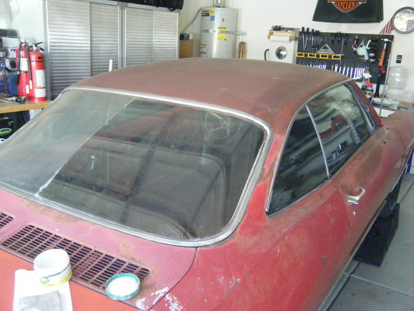

Worked on the windows a little. Davemotohead hit a homerun with that A-MAZ cleaner. That stuff works pretty good when NOTHING else would even scratch the surface.
This is a really quick first hit to get off the majority of the mineral deposits. Did it by and, just like waxing a car. Let the paste dry and wipe it off, it turns into powder that absorbed all the minerals. Pretty trick. Will re-do them later inside and out for real with a buffer, but this is the first blush.

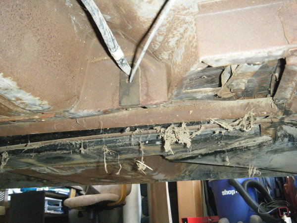

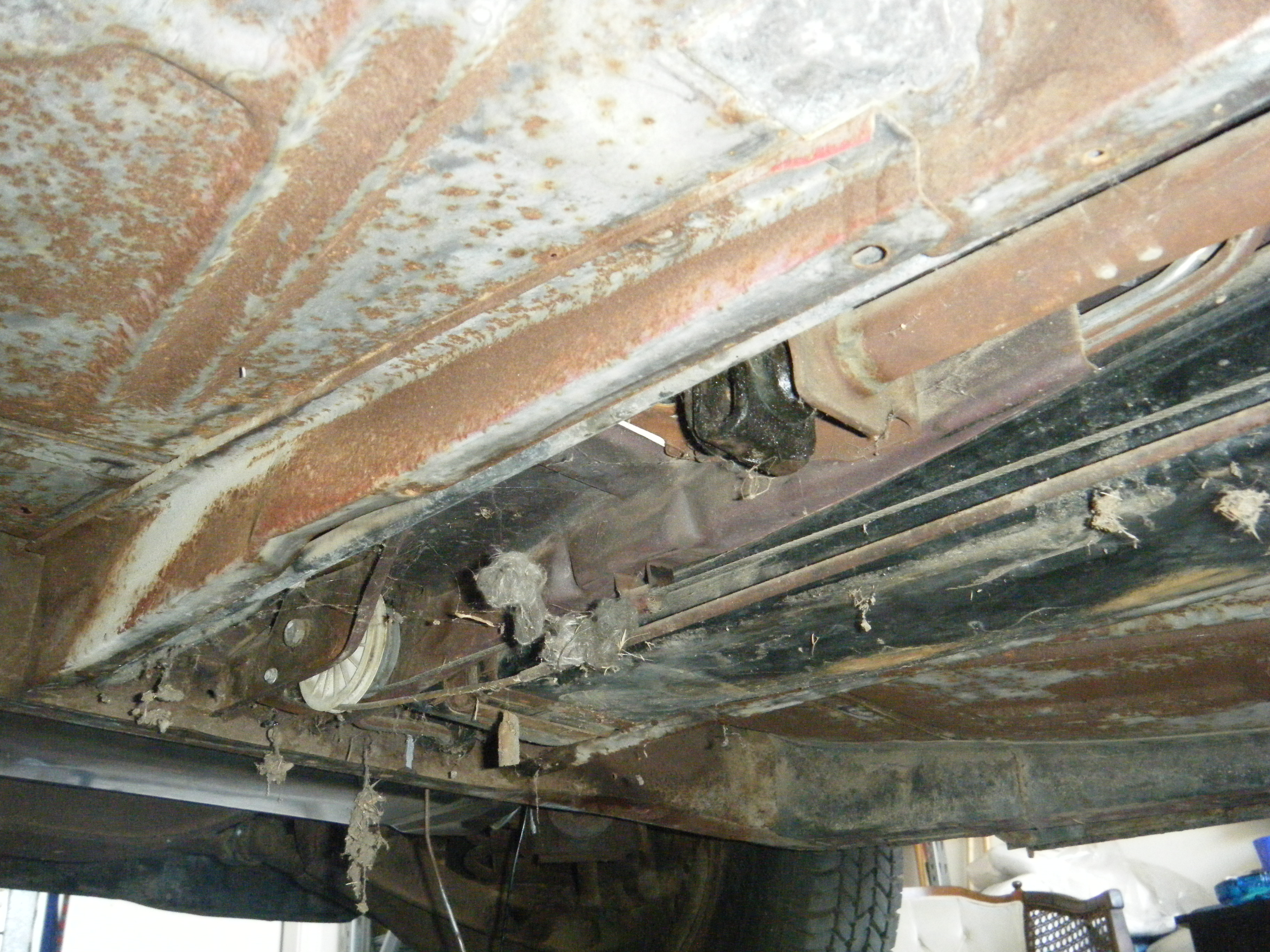

Lastly, I dropped the tunnel covers for the first time. Lots of webs and a couple nests. Let me just say that I Shop Vac EVERY time before I crawl under the car sucking up spider webs and creepy stuff. I have killed no less than 6 Black Widows (Wife knows about 1...) and it creeps me out when I'm under there and have no place to move, lol.
That's it for today. Started a little on removing body sealer from inside rear. What a PITA. There must be 30 pounds of that stuff in the interior. I'm going to have to go get a multi-size selection of metal putty knives or something.

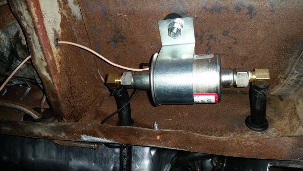

Hi guys, Been out for awhile, but I'm back and got a chance to work on the car today for a bit.

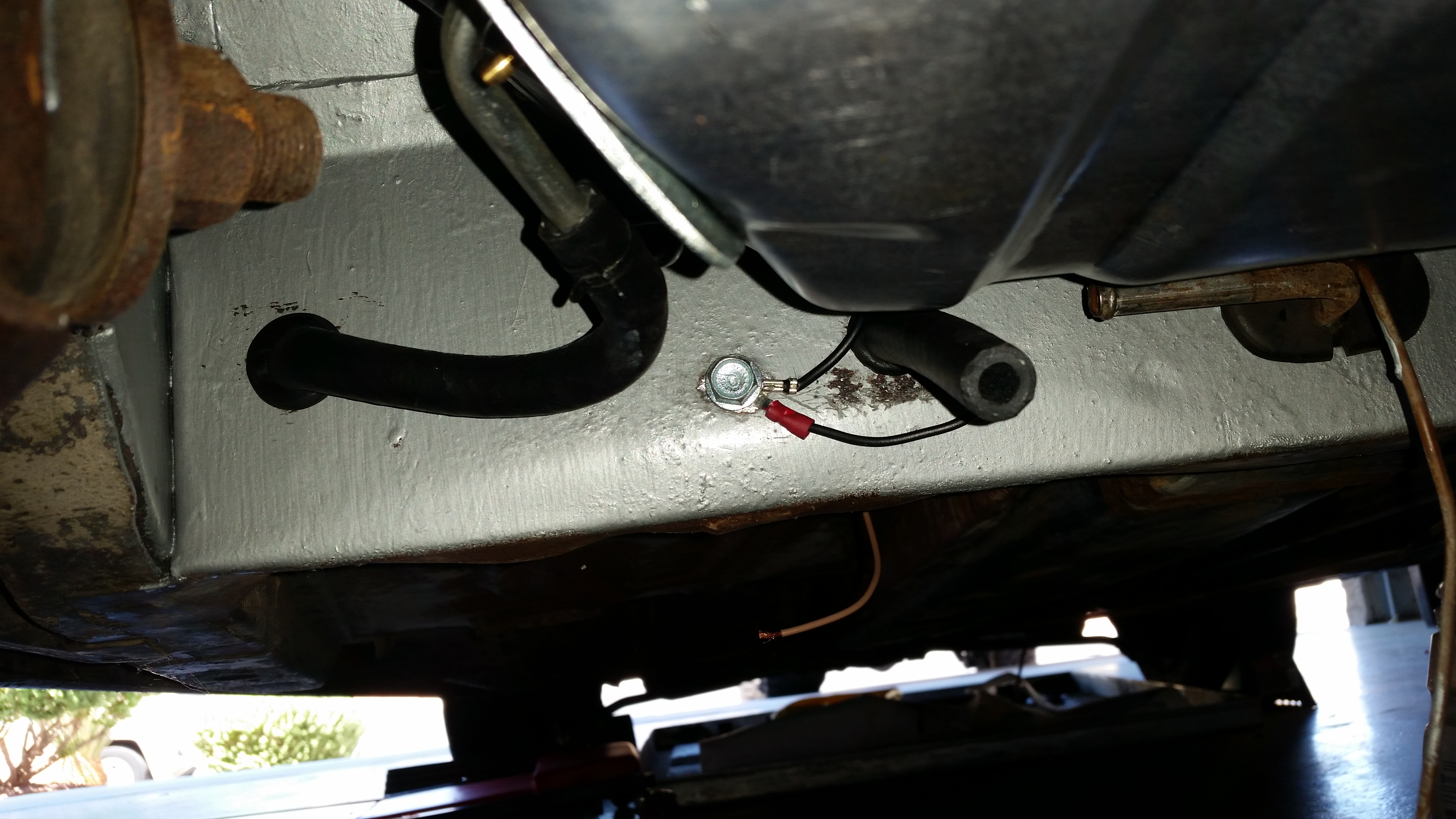

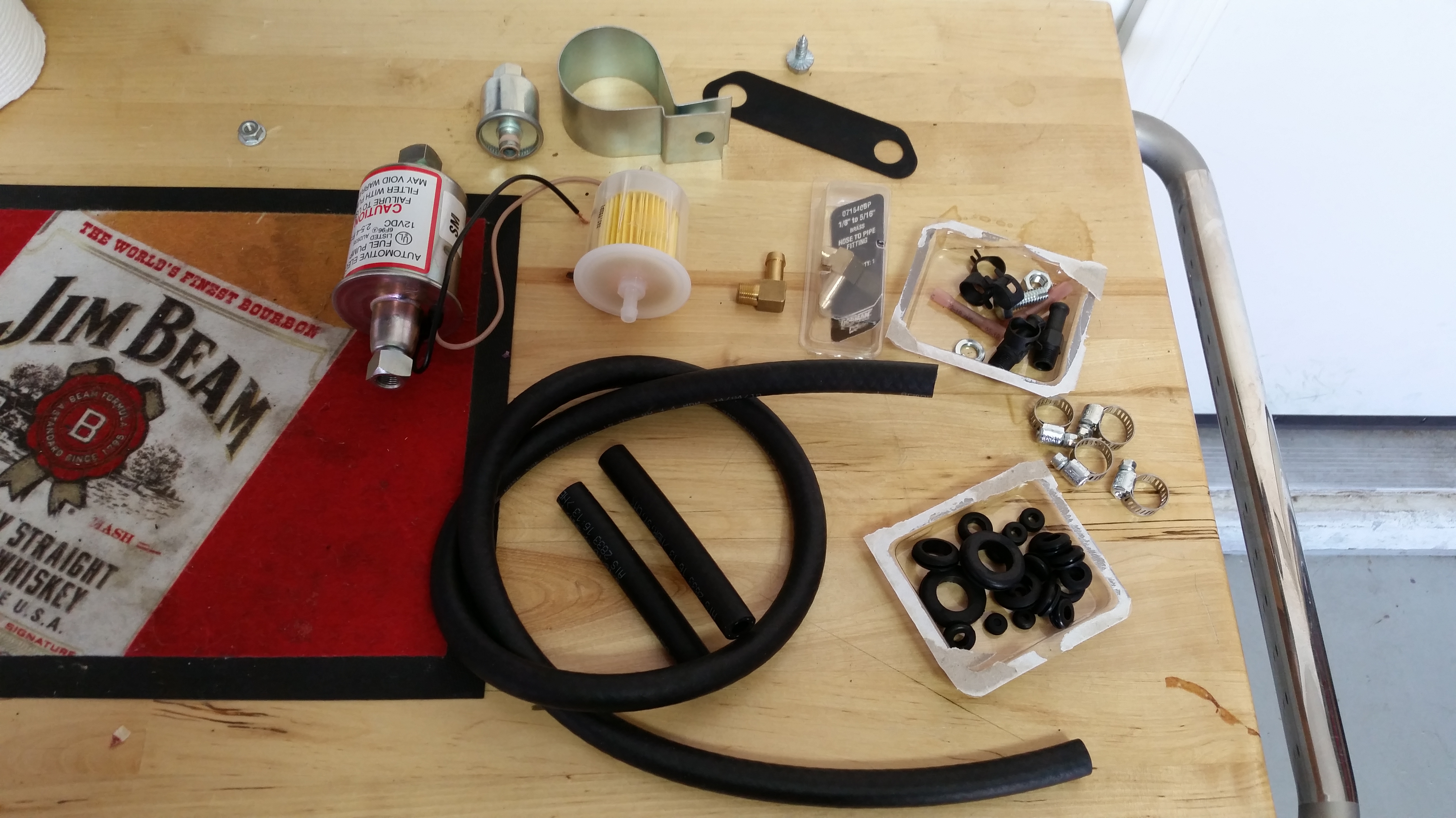

Finally got a chance to put the electric pump in. One of you old head Corvair guys could probably knock this out in an hour, but it took me most of the morning, lol.
Got my stuff together. Pump and stuff that came with it, 2 packs of wire grommets from FLAPS, and 2 90 degree threaded ends (also from FLAPS). A couple feet of fuel line as well. Make sure you get the cheap stuff, don't need the high $$$, high pressure line:

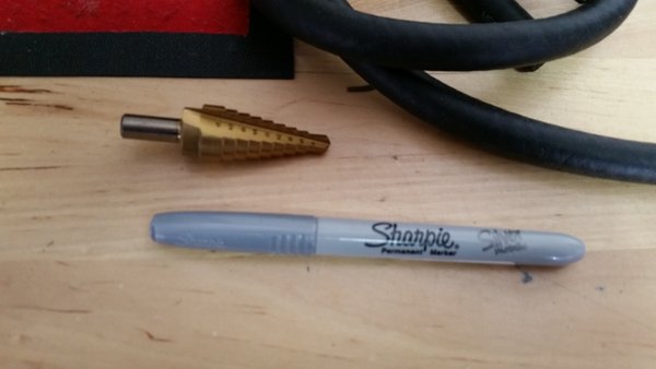

Couple special tools. IMPOSSIBLE to see pencil marks on dark, rusty metal for drilling holes. Use a Step Bit and a Silver Sharpie.
Pump 8016, 2.5-4 psi:

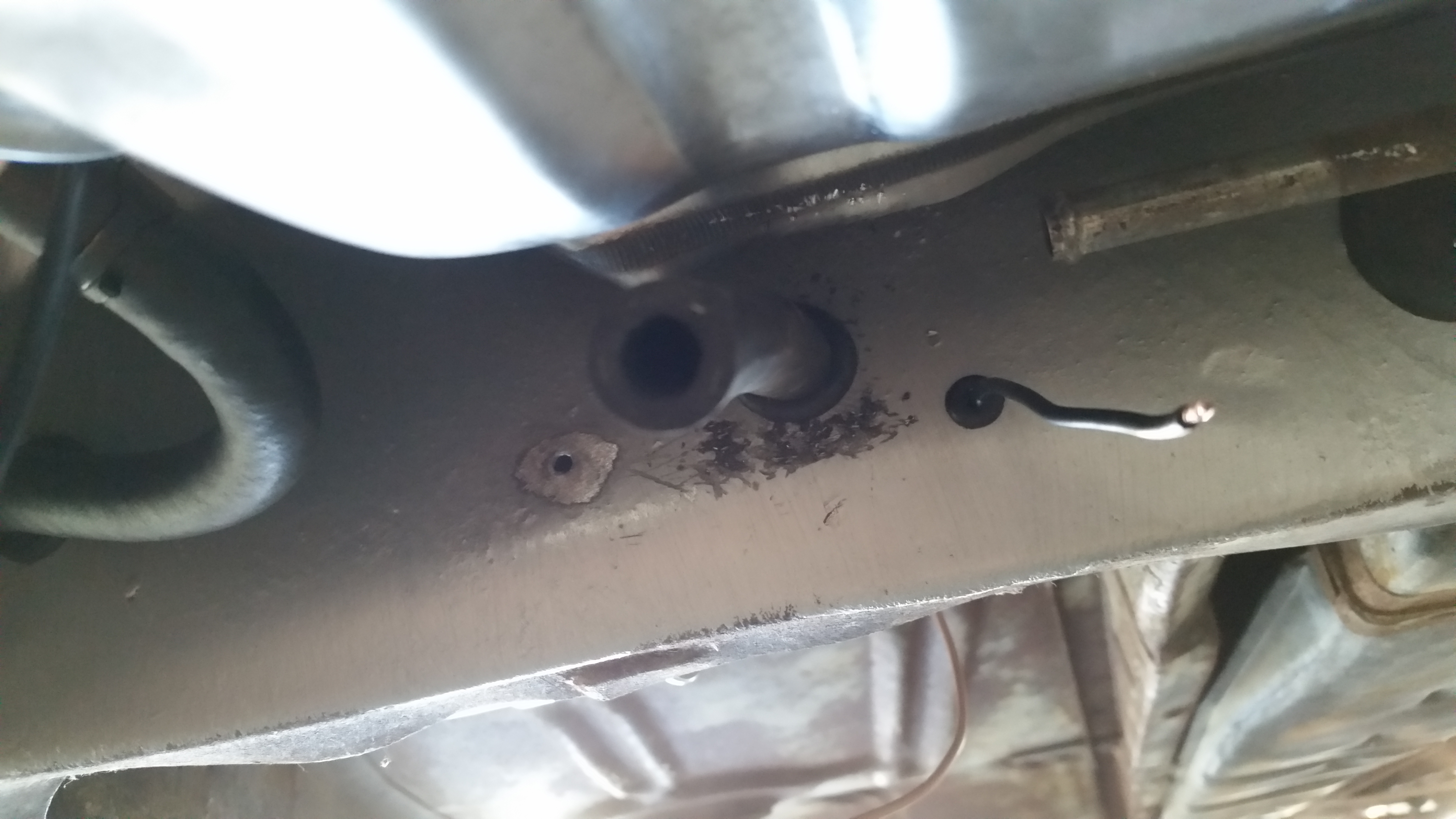

Okay, so not the most Pro job but it should work. I decided to take the inlet and outlet both back out to the factory spot instead of sideways into the tunnel. That way I don't have to cut and flare the new fuel line. Always grommet everything going through metal, even the wires get their own little hole and grommet. I also used some rubber I had in scrounge to isolate between the pump and floorboard.
Speaking of that, I have no idea how anyone can get the mount point on the frame rail. No way my drill was getting up there. I decided to bite the bullet and mount right through the passenger floor. After I rust bullet, eventual dynamat, and eventual carpet, I don't think that little bolt head will be noticeable.
One other note. Make sure you grind ANY ground point down to bare metal.
After much thought on it, I ordered Ray Sedman's Fuel Controller (relay) as the safety device for this pump. I really didn't feel like running wiring for a second oil pressure switch, or using an inertial. I figure the Tach Trigger will work fine and it'll still prime on startup. I didn't get it in yet, so I haven't wired the hot side of the pump, but I did grommet it through into the tunnel for now. I also haven't hooked up the "Out" side of the line yet, because I'm going to be changing the long lines in the tunnel for brake and fuel, just haven't dropped the power pack for routing or gone into the tunnel deep enough yet.

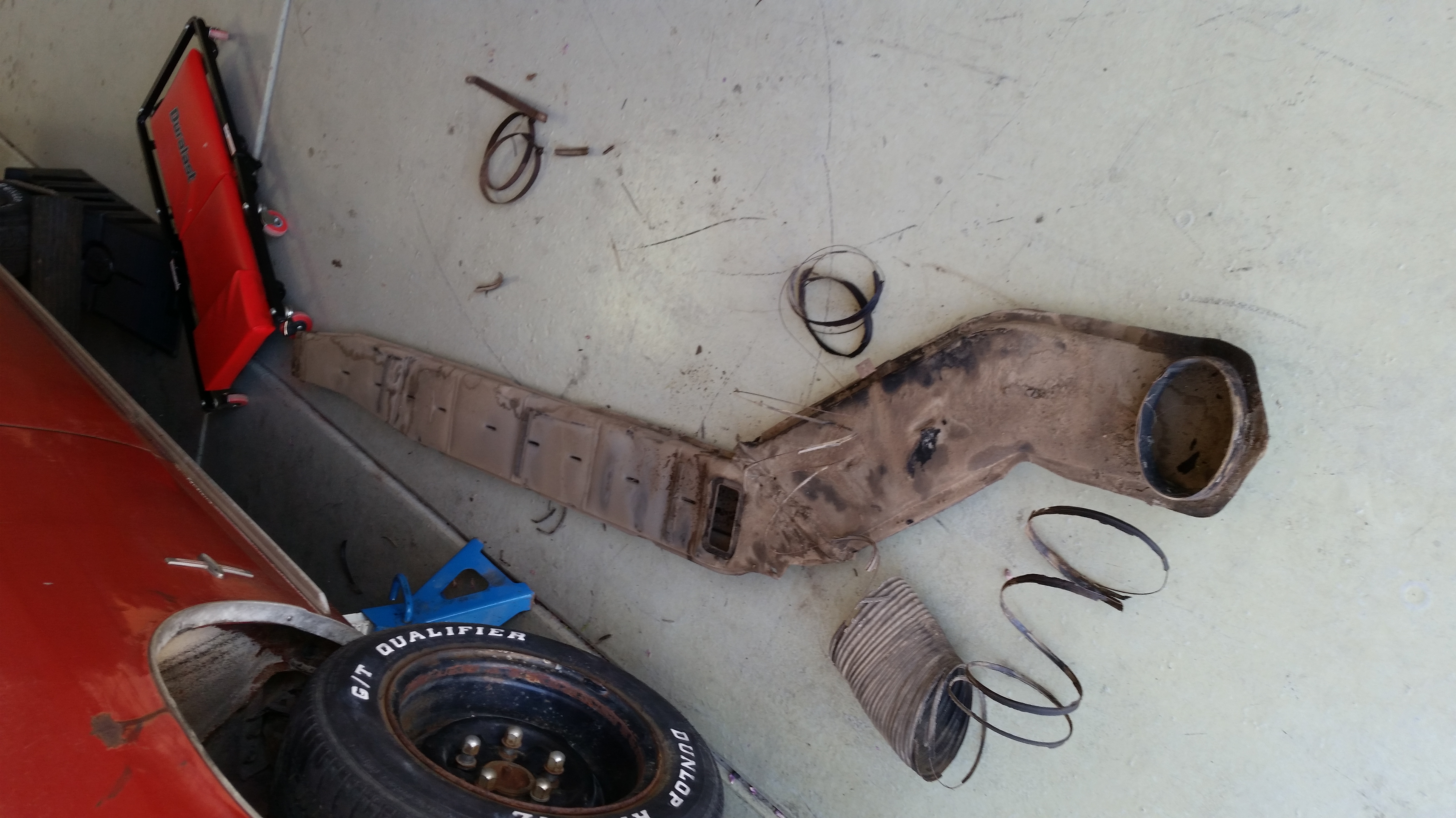

I did manage to get the heater ducting out of the tunnel also. Not too bad, just filthy. Hosed it out and a couple mouse nests came out as well, lol.

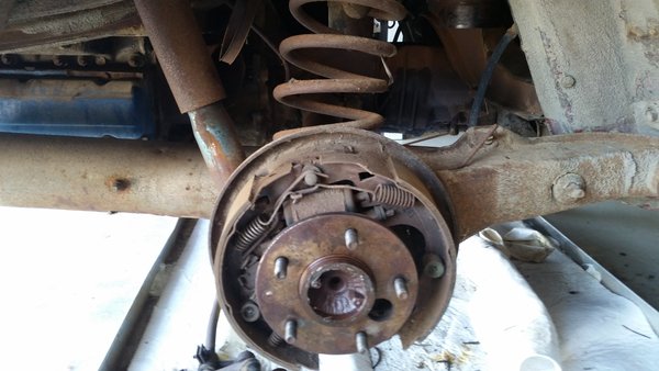

I ordered the Super Duper, end all-be all brake kit from Clark's along with the Dual MC conversion and got it in the mail yesterday. I didn't start on it yet, but did a little prep. Put all 4 up in the air, pulled the wheels and 3 out of 4 drums. One is being pretty stubborn, so have it soaking overnight in a dousing of PB Blaster.
Sample of 30-something year old brakes, lol.
I'll start on the brake re-do another day. Will be all brand new From the new dual MC to the pads, even all the hard lines. :tu:

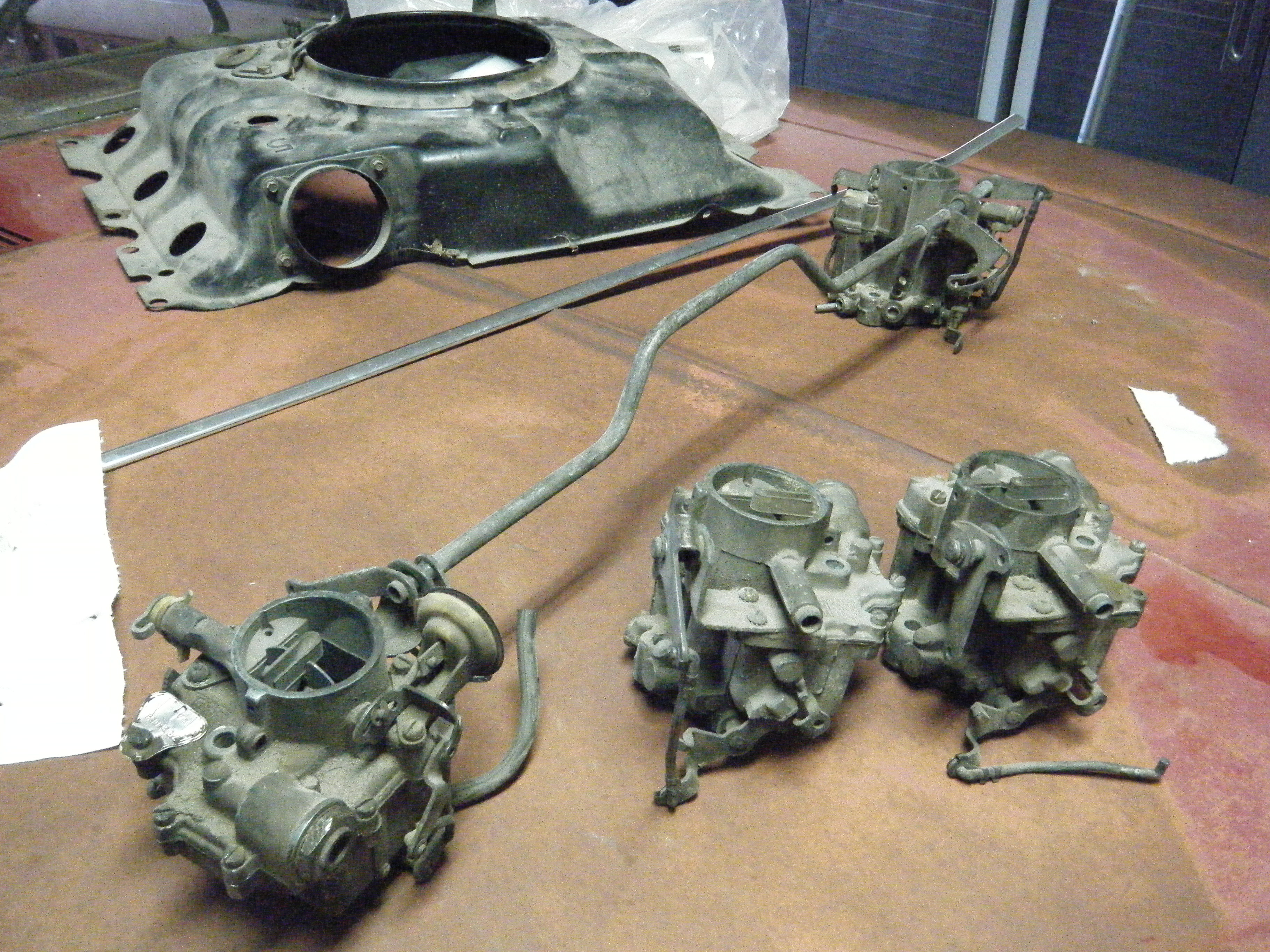

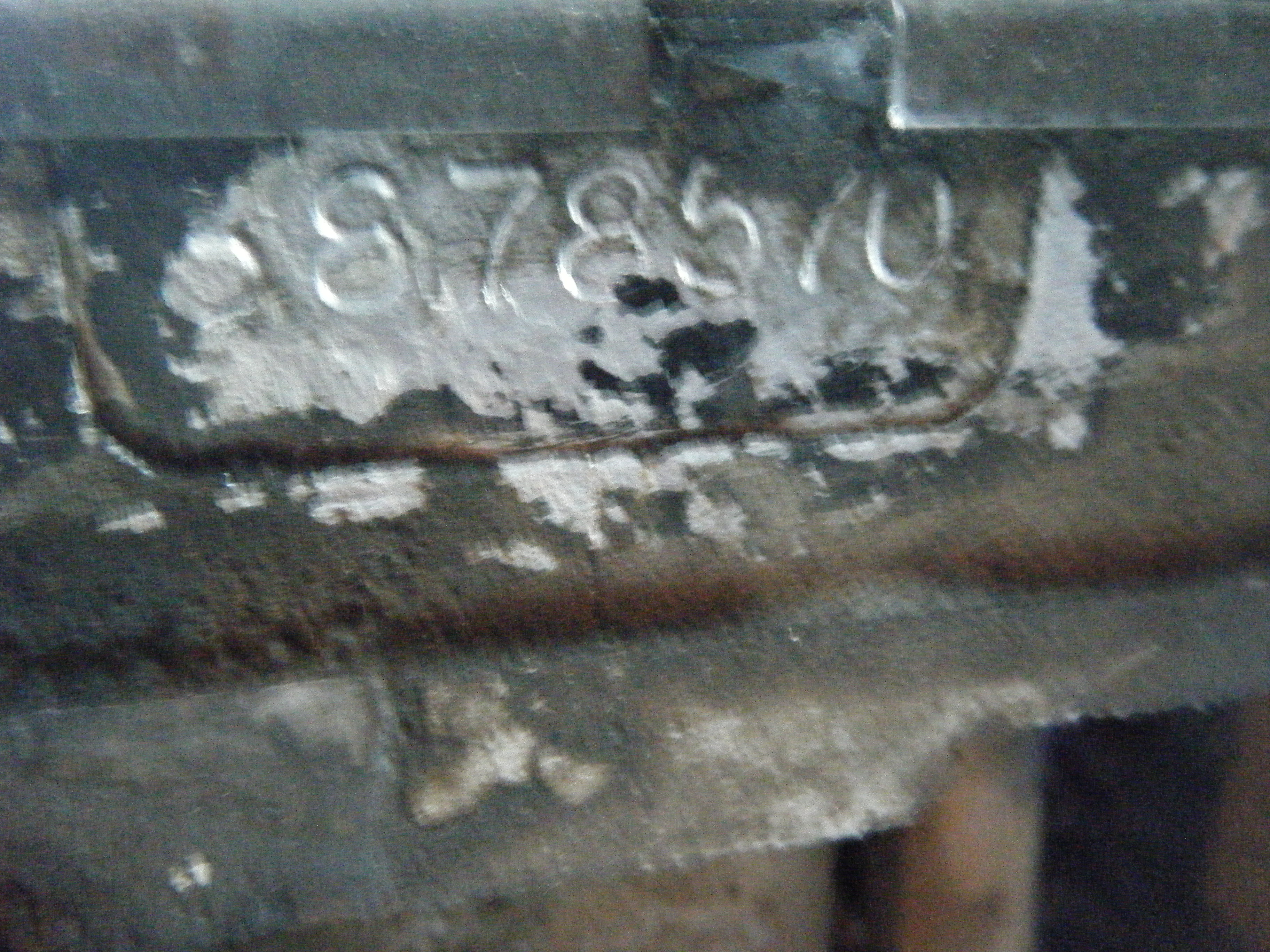

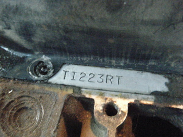

Finally, I had posted a thread for some engine info, and Notched was really helpful getting me on track. See Here:
viewtopic.php?f=40&t=8296" onclick="window.open(this.href);return false;" onclick="window.open(this.href);return false;

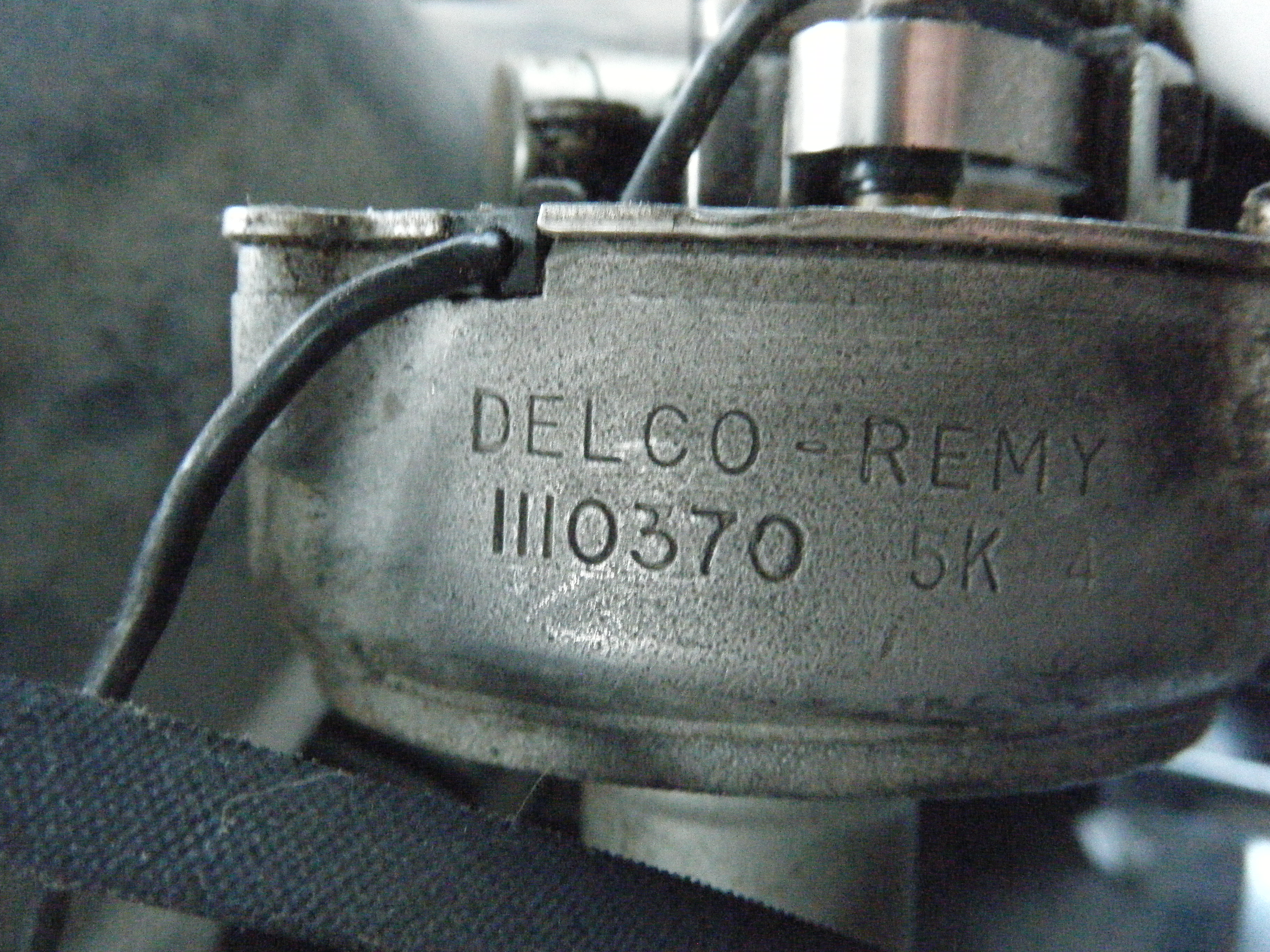

In a nutshell, The 140 I have is a "RT" code for a '66 smog motor, which makes sense. Don't think it's the original motor for the car, but should work out okay.
The only thing that threw me for a loop a little is this dizzy that is kind of an oddball I guess.
I did finally find in the CORSA Tech Guide, Vol 3, that it lists it out as a '67/ 140/ MT/ smog. So instead of trying to track down and rebuild a 330, I think I'm going to roll with it? Maybe?
Anyone have input on this? I've read that the -330 is the "go to" dizzy for the 140 MT's, but does anyone in the know have a good opinion on this oddball one?
The engine in the car is a "YN" code, btw. I did pull all the plugs from both motors and squirt a little PB Blaster and a little Marvel Mystery Oil in there. Haven't pulled the valve covers yet, but both engines will rotate from the crank pulley. I went nice and easy and will rotate a little at a time for a few days and let the oils work their magic. I'll follow the "How to revive a 20 yr old engine" guidelines, but I was curious on whether or not I had boat anchors or not. So a small prelim victory on that front.

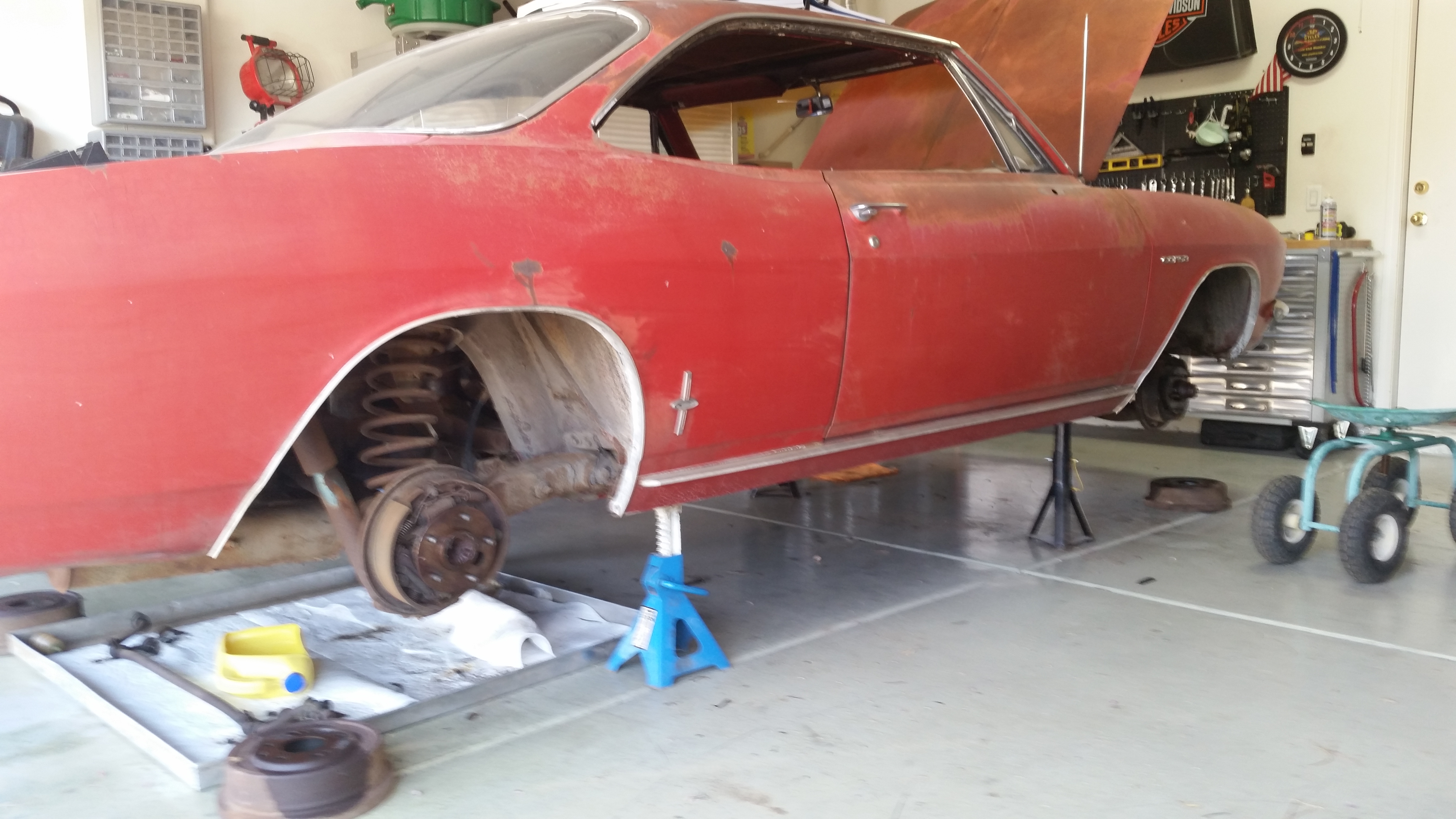

So, haven't done too much lately, been busy. Corsa is still airborne and haven't installed the brakes yet.
I did get my new coils from Coil Spring Specialties today though, so I'm super excited to get working on her again.
I know...I uploaded a picture of a box, lol. Pretty exciting stuff, no?

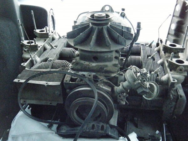

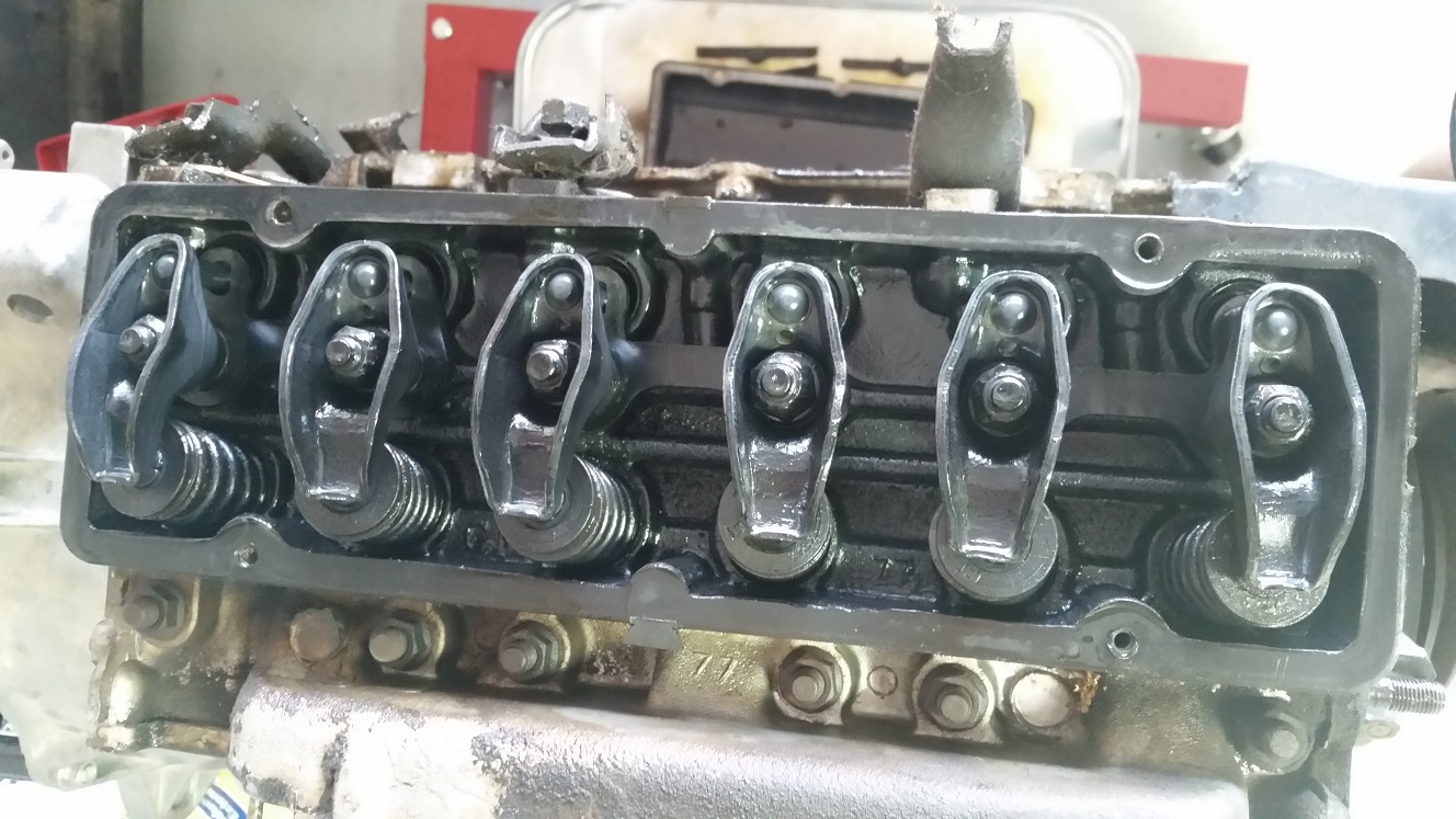

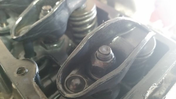

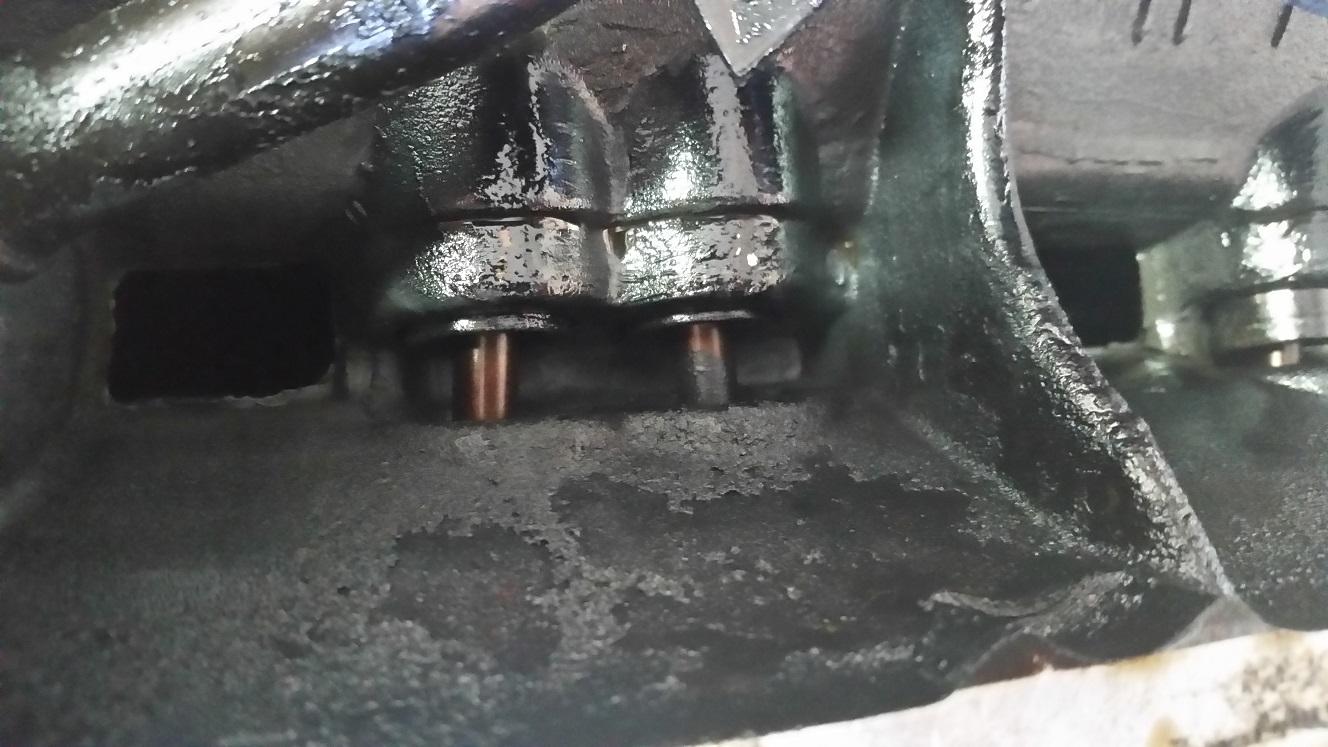

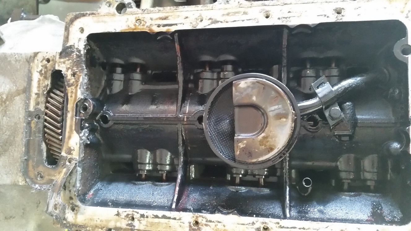

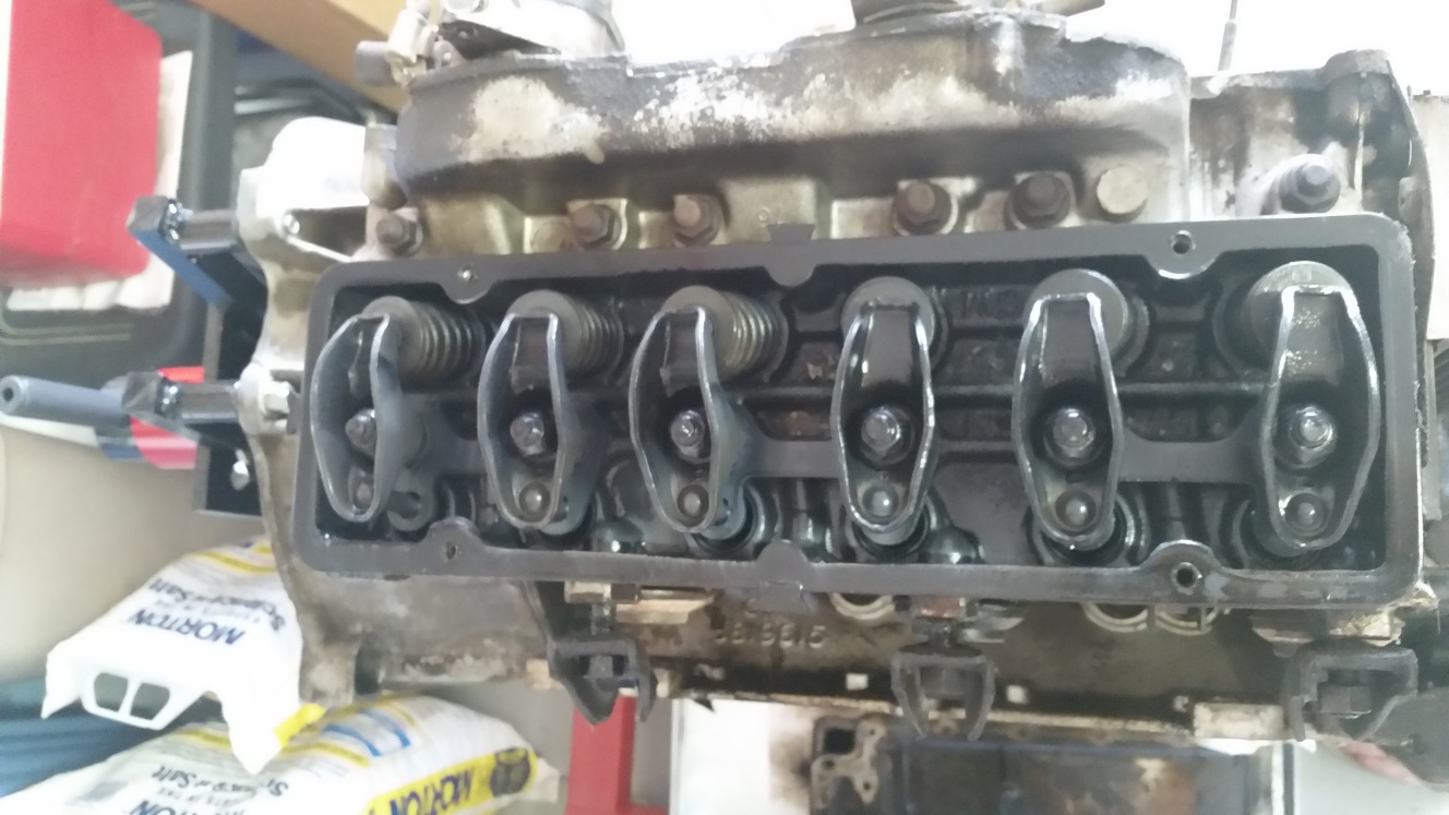

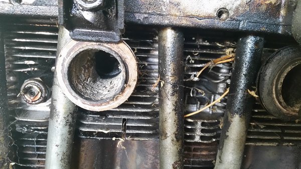

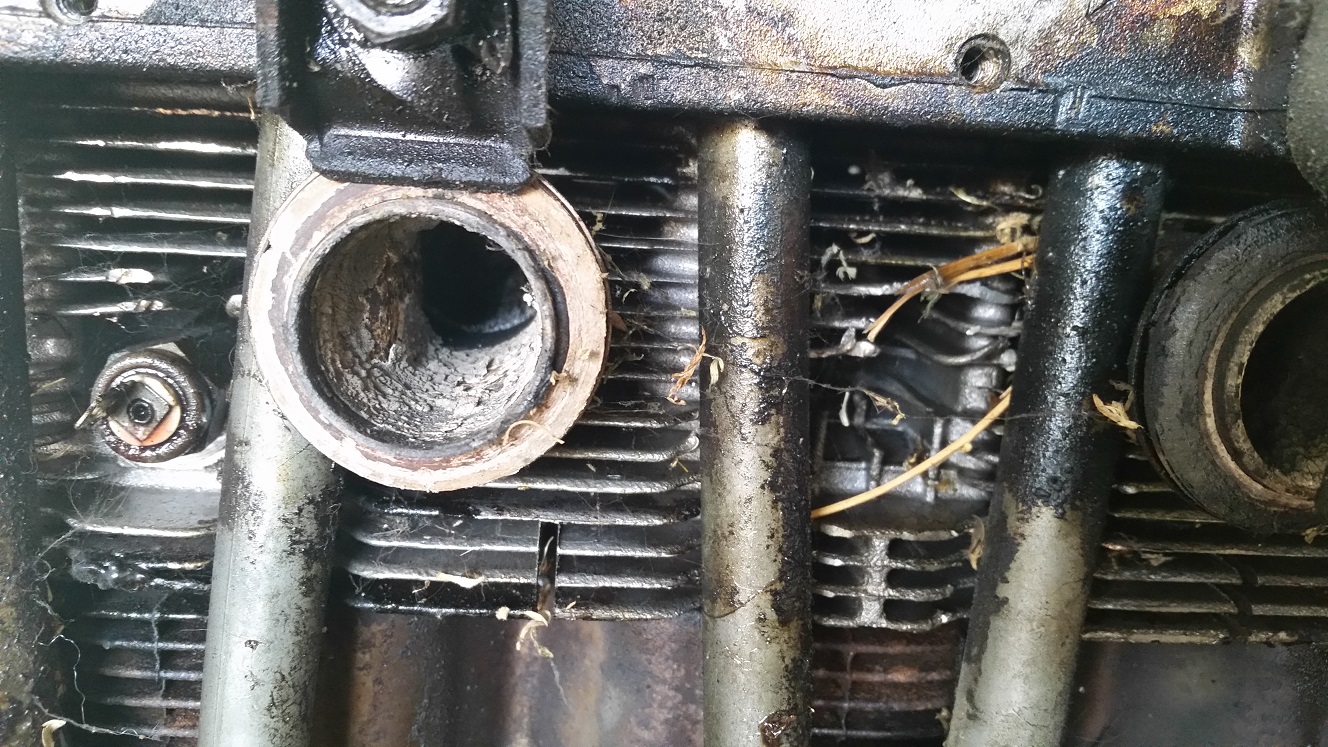

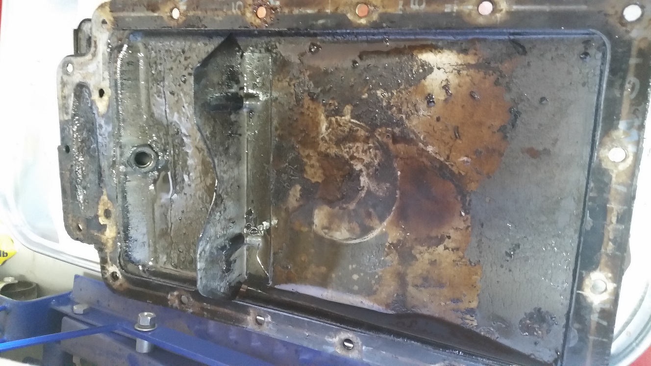

While I haven't worked on the car, I did get the 140 free'd up and turning over with the crank nut. Also pulled the valve covers and oil pan to see whats up. Nothing looks catastrophic (I don't think?), and by that I mean all the valves seem to move, the lifters go in and out, and there aren't any giant chucks of steel and aluminum in the pan. SOme chunks of what used to be a couple o-rings though. There's a lot of sludge, carbon build up (or old crusty oil?), and some weird whitish build up pretty heavy in the exhaust ports.
I really have NO idea what I'm doing, but figured I'm probably not going to screw much up that isn't already shot, so might as well dive in. I'm following the steps in the thread on reviving an old motor, but since my engine stand lets me spin the whole motor around, I'm doing that too.
I squirted some PB Blaster and MMO in the cyclinders, hosed down under the valve covers with PB Blaster, and then I turn the crank a half turn every day and rotate the whole motor 90 degrees every day. I figure I'll just coat everything inside with that stuff for now and try not to break anything I don't know how to fix.
One thing I noticed is that the consensus seems to be for a cold adjustment to be zero lash plus a half turn. Generally leaving 2 threads exposed or so? EVERY rocker has 4-5 threads showing like this pic. I also don't know if it's normal, but as I'm turning the crank pulley, with no plugs in, the motor kind of makes a VOOOOOOP, VOOOOOOOOP, kind of sucking sound. I know that's not going to mean much to anyone....

Re: County98's Learn as I Go Thread
Thanks for the pics!
White deposited are probably lead. Engine looks pretty black inside. Lack of oil changes and or running hot. Sound you hear is normal from air rushing in and out of spark plug holes.
